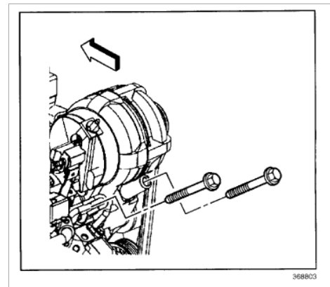

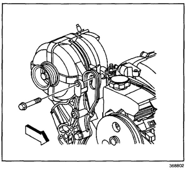

Here is how to replace the alternator on your car (below)
Tighten
Tighten the generator bolts to 50 N.m (37 lb ft) .
Tighten the generator nuts to 30 N.m (22 lb ft) .

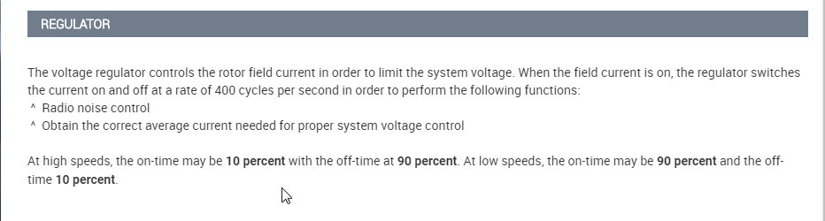

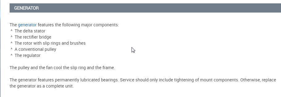

The battery light could be caused by the battery light, but we need to find out how the tech tested the alternator. Here is a guide to either ask the tech how he tested it or have it performed as such:
The other thing we need to question is the voltage regulator which is part of the alternator/generator.
