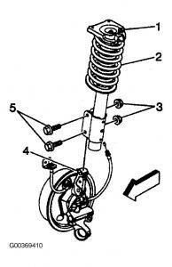

ok, i have a 02 Malibu, everytime i hit a bump or ot hole (where i live it's unavoidable)(western NY) theres a rattle in the rear passenger side of the car, i took it to a dealership and asked them what it might be they said it was a rear strut mount, and that all i might need is tightned, so i took it home and tightened it up, but it still rattles, and before i tear apart the whole rear end was wondering if it was even te problem or mabey just the strut retaining nut was loose, if there is one, just to save me time and money. any info would be awsome thanks

You need new struts
check the coil spring
you need a special spring compressor to remove the struts from the springs
be very careful when doing it
