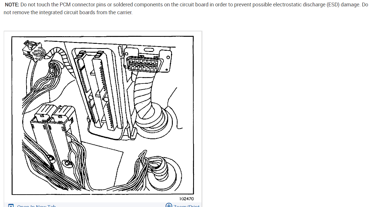

I need to know where the ECM is on my 2001 Malibu?

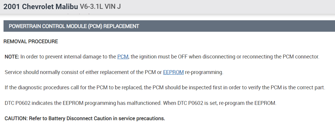

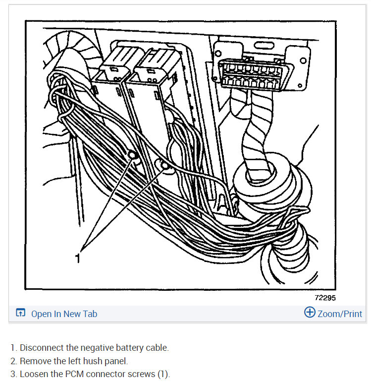

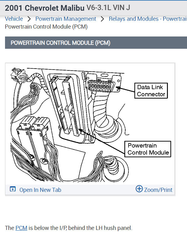

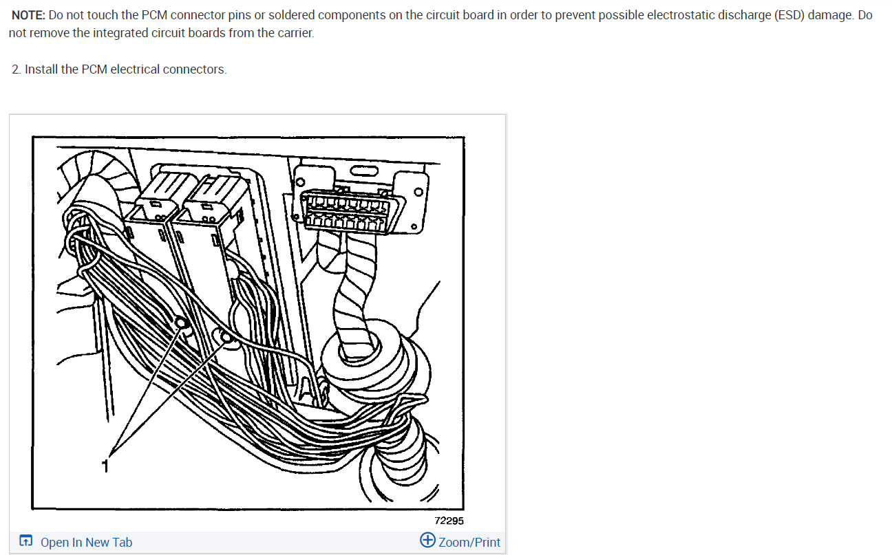

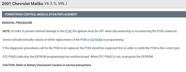

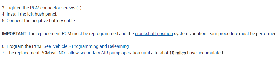

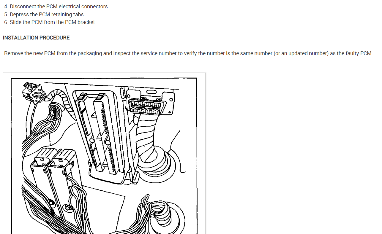

the PCM is behind the lower left dash near the steering column. Here is how to change the PCM out and the location, you can get a preprogrammed unit by searching Google or Ebay. Check out the images (below). Let us know if you need anything else.
Jan 10, 2006 at 5:29 AM
Suggested Repair
The PCM (ECM) is behind the lower left dash near the steering column. If replacement is needed, use a preprogrammed unit.
