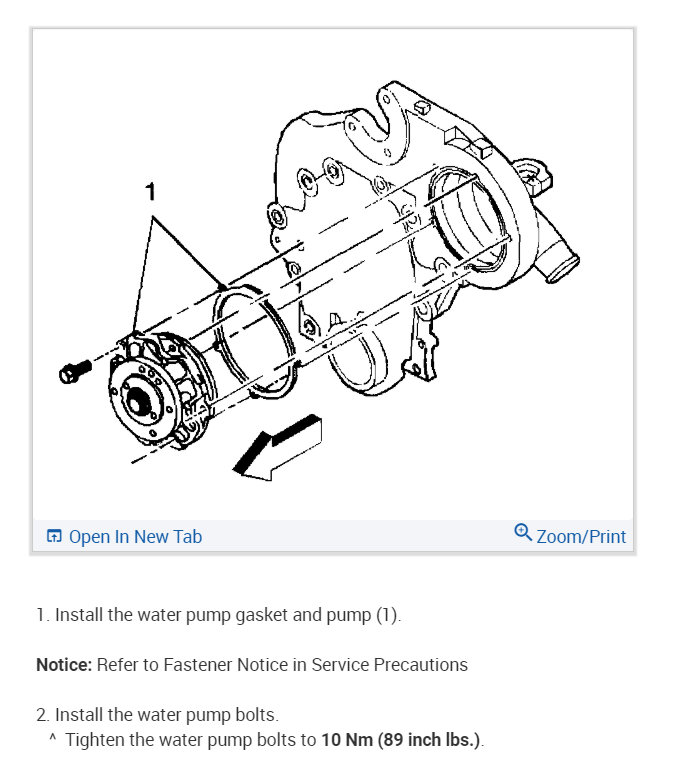

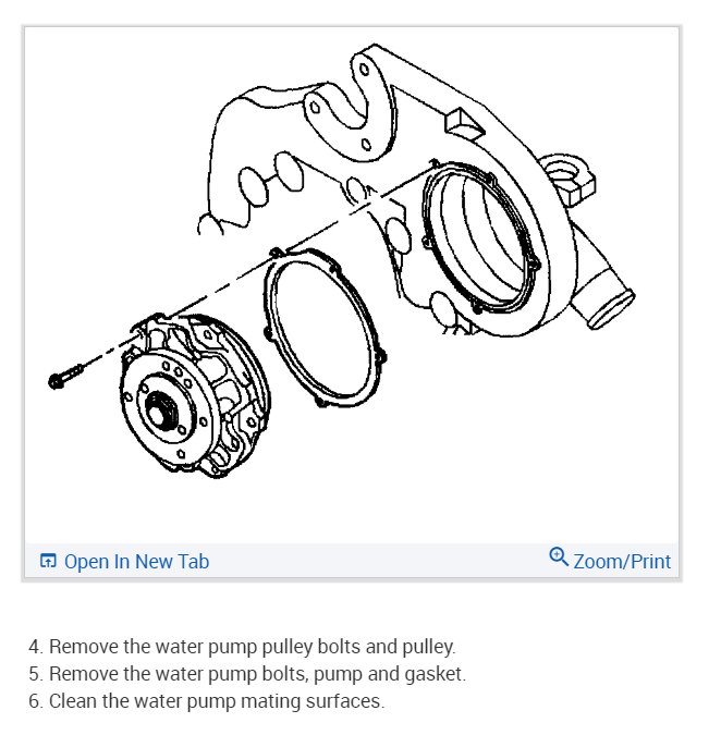

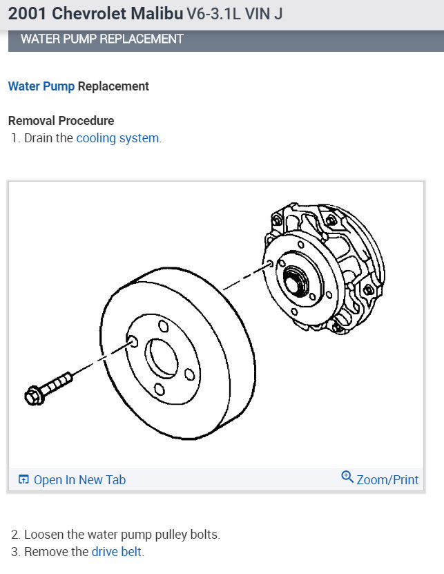

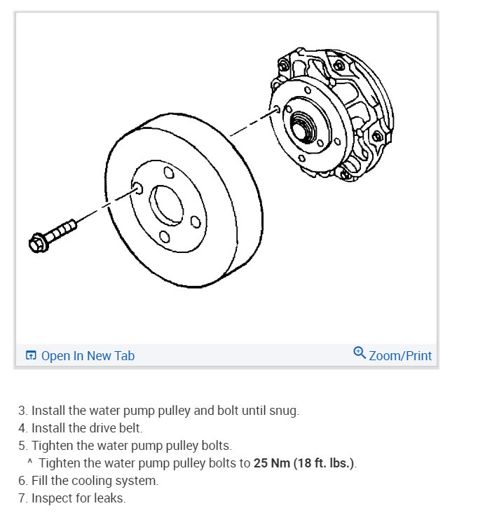

How do you install the water pump so the bolt pattern is correct.

This guide will help walk you through the steps and I have included the instructions to replace the water pump in the diagrams below
https://www.2carpros.com/articles/water-pump-replacement
