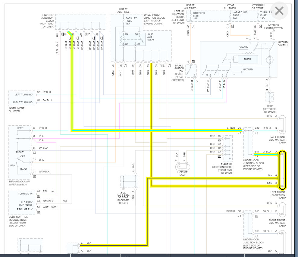

Hello, my cars parking lights came on with no key in and stay on. The car won't stay running dies immediately. I believe there may be an open ground somewhere but I don't know where to start. Also the dash lights take a few seconds before they come on then they stay on and never go off and the door locks have no power to them, the dome light also won't come on.
I believe the car will start once I find the short in my electrical problem. Any suggestions would be really appreciated.

More than likely the park lamp relay has stuck. What I would do is check the operation of the relay and find out if it is sticking.
Here is a guide that will help with doing this testing:
I would suggest checking the voltage coming out of the relay if the relay tests ok. If there is voltage but the relay is not closed, then you have a short in that circuit.
Please run through this info and let us know what questions you have. Please see the wiring diagram below that will help with this as well.
