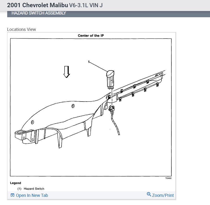

where is the flasher located in the 2001 chevy malibu?
Mar 5, 2010 at 11:30 AM
  • 110,240 POSTS

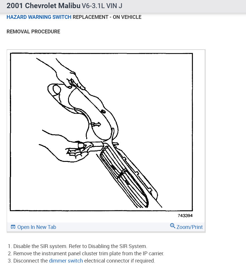

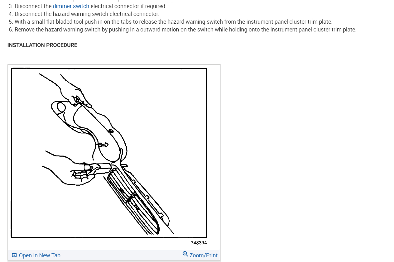

The Hazard Flasher and Turn Signal Flasher have been integrated with the Hazard Lamp Switch. Here is the location of the hazard flasher and instructions on how to change it out. Check out the images (Below). Please let us know if you need anything else to get the problem fixed.
