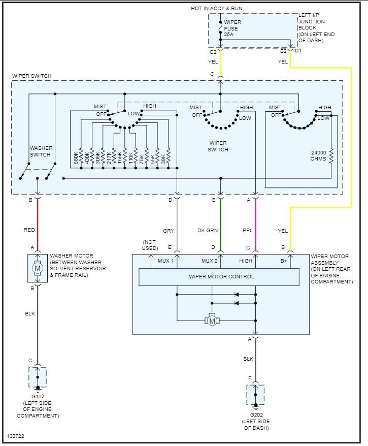

Doe's the windshield washer pump have its own fuse?

No the washer pump does't have its own fuse it is tied in with the wiper motor and other items if its mot working check that all hoses on the hood are connected and in good condition. Unhook the hose at the spray nozzle and see if fluid comes out. Its really common for the nozzles to plug up and not spray
The wiring diagram for your wiper/washer system is attached below

I have replaced my washer pump thinking that it was the problem, but still doesn't work. If the new washer pump is hooked up it does not communicate to the steering column device and the wipers do not come on, if I unhook the pump the wipers come on like they should when asking for washer fluid. I do not believe the lines are clogged or any fuses are blown but could either of these things be the problem. Sick of having dirty windows.

The wiper functions are controlled by the BCM and I believe that is the cause of the problem.
Appropriate scan tools would be required to scan for trouble codes to determine the fault. It is also necessary to use the scan tools to perform testing of the washer circuit.
