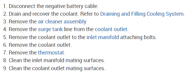

How difficult is it to replace the thermostat in this vehicle?

Its only two screws but I tell you it a capital B to do one of them

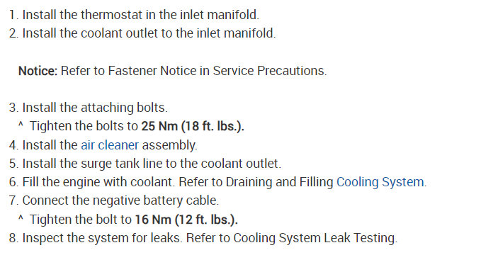

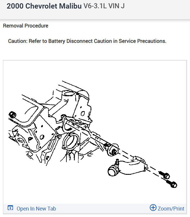

It is not to bad, they are two 13mm bolts, here is a generic guide to help you step by step with instructions in the diagrams below to show you how on your car.
Check out the images (below). Let us know if you need anything else.
