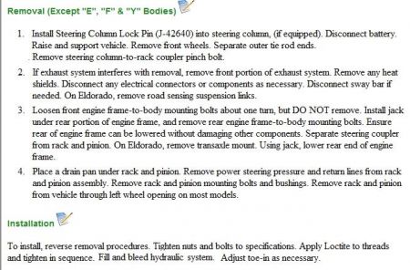

how do i install a steering rack for a 2000 chevy malibu?

https://images.2carpros.com/forum/automotive_pictures/261618_Noname_2397.jpg
