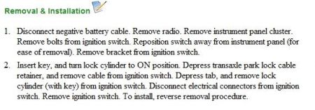

how do i change the ignition lock cylinder in my car? SOMEONE SAID SOMETHING about reseting something after you do it i need to know how to do that too!
May 30, 2010 at 11:20 AM
BLUELIGHTNIN6
  • 16,542 POSTS
https://images.2carpros.com/forum/automotive_pictures/261618_Noname_2282.jpg

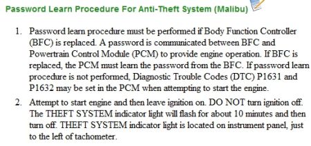

nothing needs reset, not sure what you mean..?
May 31, 2010 at 12:23 PM
MAMA.OF.4.2005
  • 5 POSTS
when i called napa about the part they said you had to take it to a shop to fix it cause something had to be reset cause of the anti theft in it
May 31, 2010 at 12:39 PM
BLUELIGHTNIN6
  • 16,542 POSTS
okay, yes if you have anti theft system then the new ignition switch will have to be reprogrammed to your key or it will not work. you will have to take to a locksmith or dealer for that.
May 31, 2010 at 12:40 PM
MAMA.OF.4.2005
  • 5 POSTS
so install it and then take it or what>?
May 31, 2010 at 8:05 PM
BLUELIGHTNIN6
  • 16,542 POSTS
won't start until new one is reprogrammed, if you install it first you would have to get it towed to shop
May 31, 2010 at 8:18 PM
MAMA.OF.4.2005
  • 5 POSTS

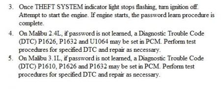

okay theres no way to reprogram it myself or have it reprogramed before installing it?
May 31, 2010 at 9:12 PM
BLUELIGHTNIN6
  • 16,542 POSTS
actually I may have found the procedure for you.. replace the switch as described earlier then perform the following steps to reprogram the system..
https://images.2carpros.com/forum/automotive_pictures/261618_Noname_2293.jpg
https://images.2carpros.com/forum/automotive_pictures/261618_Noname2_753.jpg
