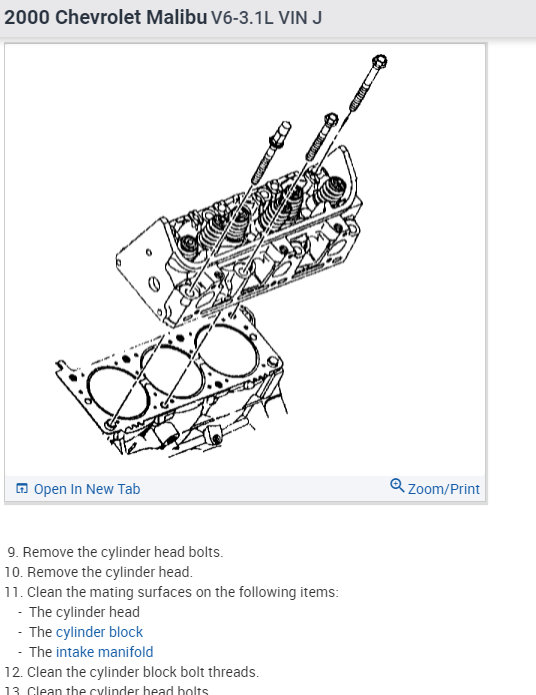

Engine cooling leaking in motor oil
MARTYZICE
  • 2000 CHEVROLET MALIBU
  • 6 CYL
  • FWD
  • 185,000 MILES

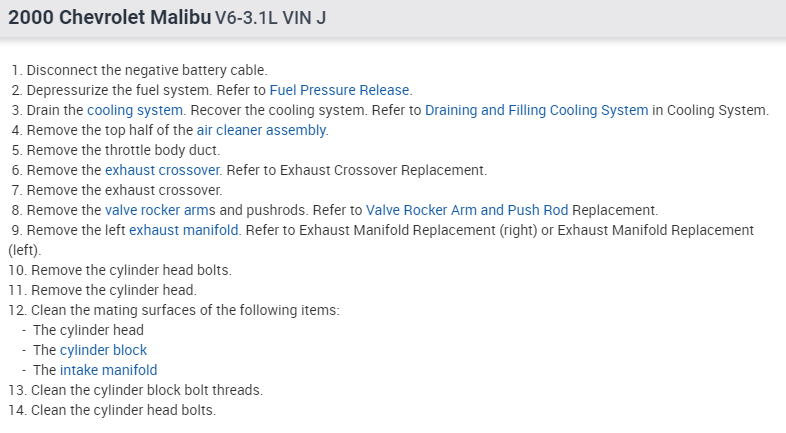

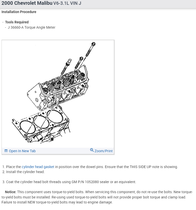

Why is coolant leaking in motor oil, now motor oil is milk-ish.
Monday, January 26th, 2009 AT 10:41 PM
SQM
  • 6,383 POSTS

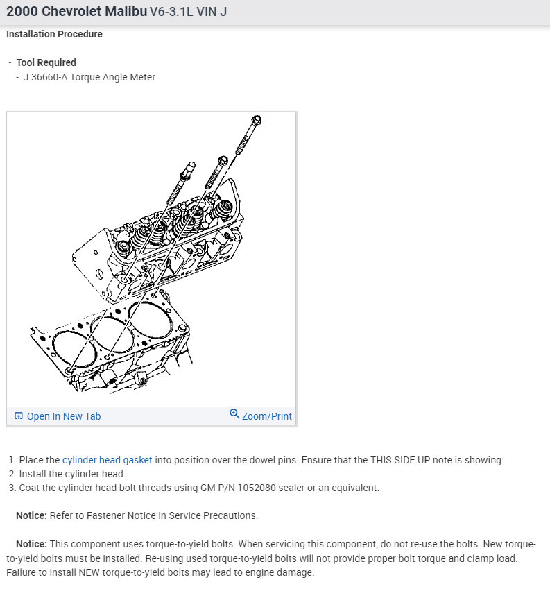

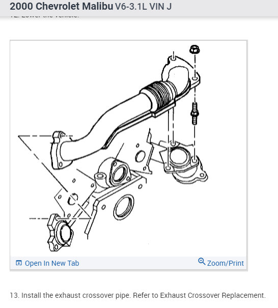

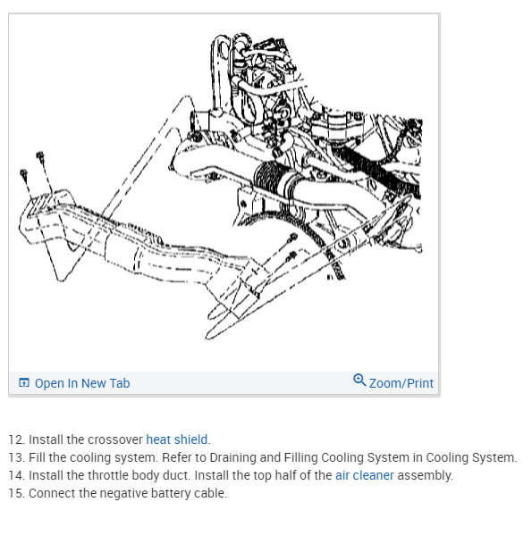

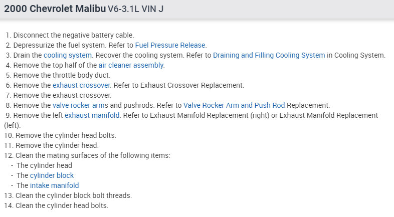

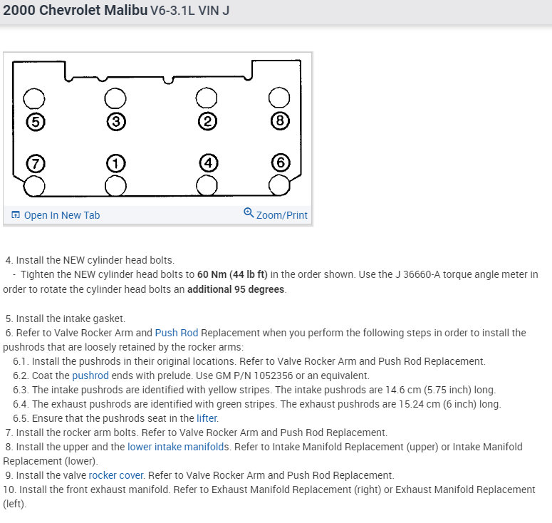

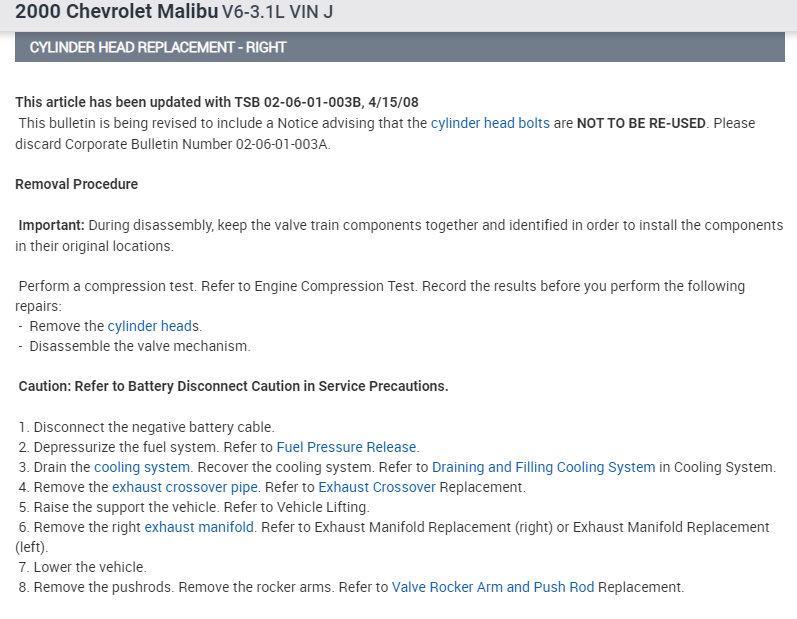

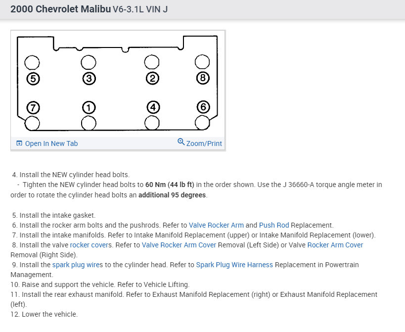

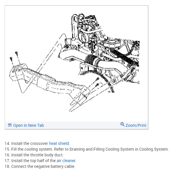

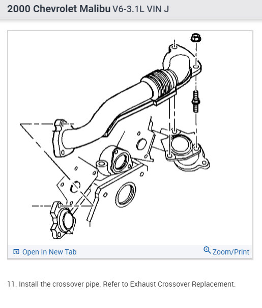

One of the common reasons for coolant leak into the oil is due to head gasket failure.
In order to get this fixed the cylinder head gasket needs to be replaced.
There are few different ways to check to see if the head gasket is blown.
Take a look at this video, it covers the typical symptoms and tests:
https://youtu.be/5zpNjYmmiYY
