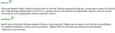

need to know how to remove outer tie rods and what tools to use. If you have a diagram it would be great thank you.

https://images.2carpros.com/forum/automotive_pictures/261618_Noname_2562.jpg
