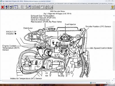

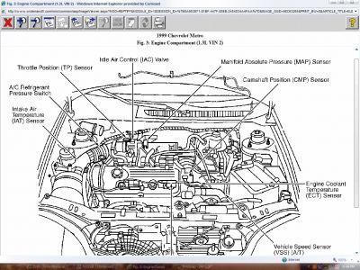

where is the ait sensor for a 1999 chevy metro. there is not a metro for model listed above for some reason.
Jul 20, 2008 at 8:44 AM
MERLIN2021
  • 17,250 POSTS
Top is 1.0 bottom is 1.3 IAT(intake air temp)
