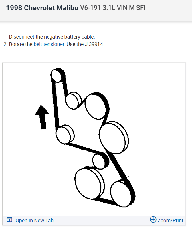

putting on serpentine belt need a diagram.

how do u put on a new serpentine belt (get it 2 fit around all the pulles)

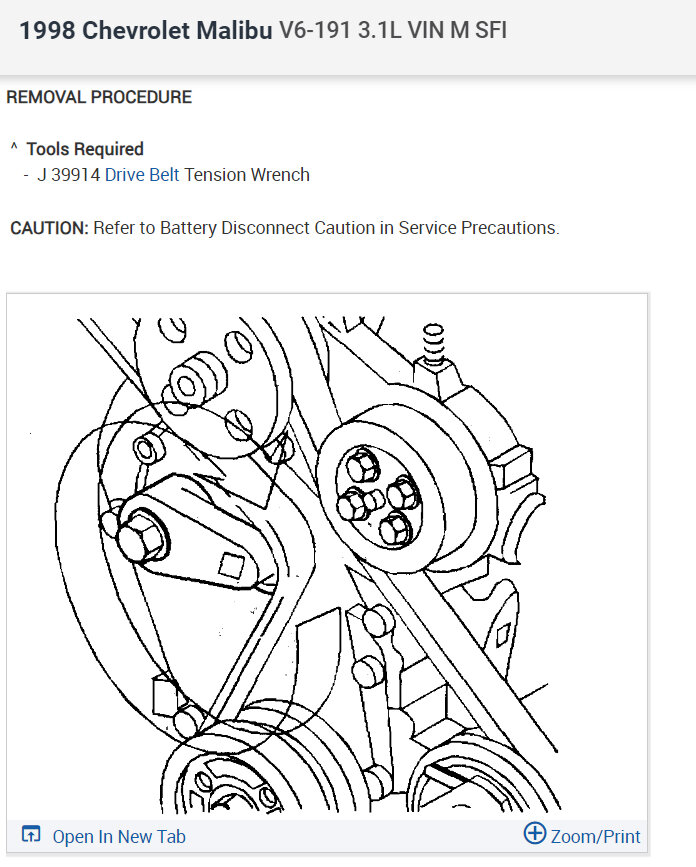

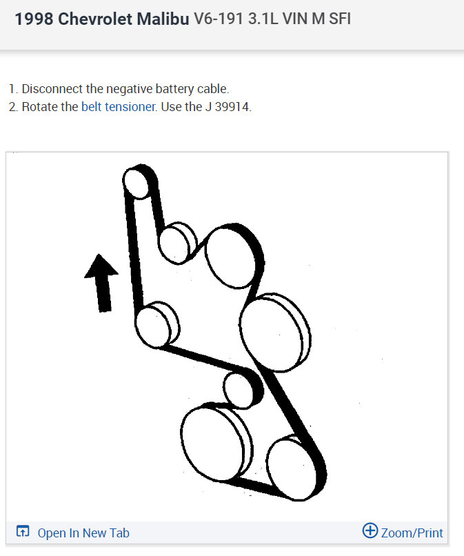

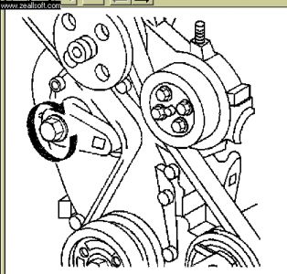

You should save the smooth pulley's for last and extend the belt tensioner fully. Here are the instructions and the serpentine belt diagrams. Check out the images (below). Let us know if you need anything else.
