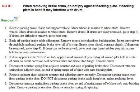

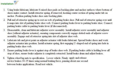

HOW DO YOU REPLACE REAR BRAKE SHOES ON A 1998 CHEVY MALIBU

https://images.2carpros.com/forum/automotive_pictures/261618_Noname_978.jpg
https://images.2carpros.com/forum/automotive_pictures/261618_Noname2_273.jpg
