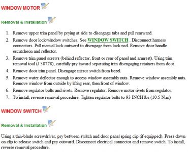

how do i take the window motor out

https://images.2carpros.com/forum/automotive_pictures/261618_Noname_2043.jpg
