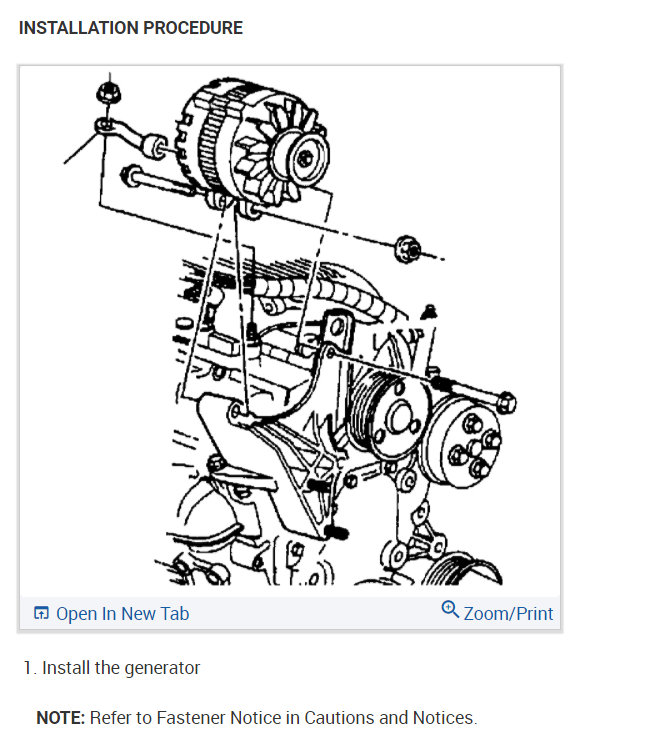

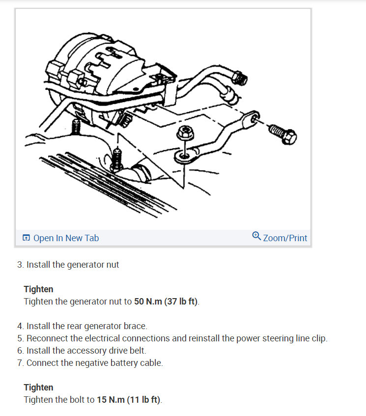

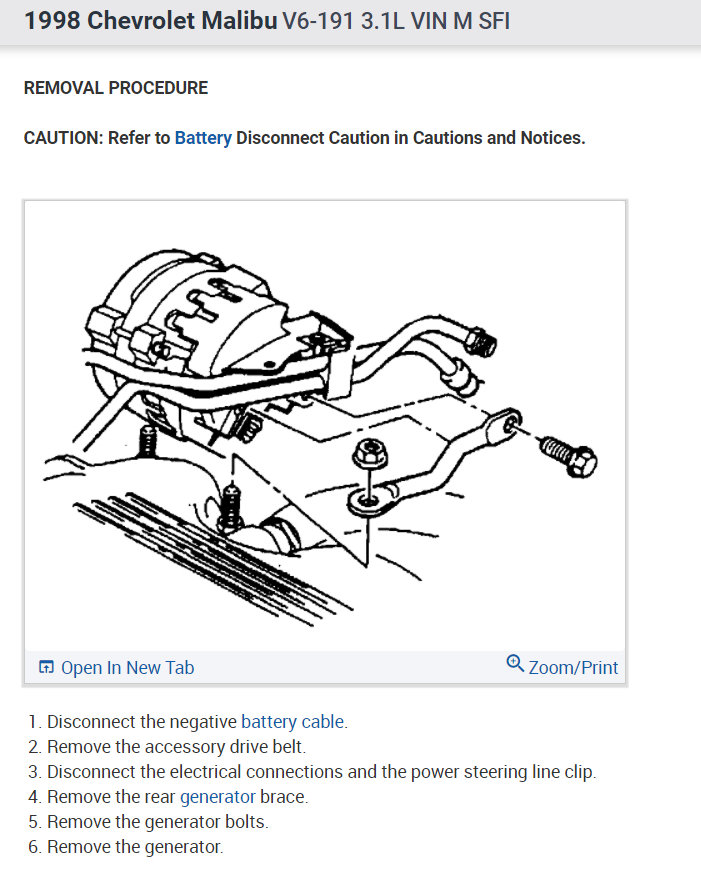

It sounds like the alternator is bad. to be sure this guide can help us:
If the alternator fails this guide to help you step by step with instructions in the diagrams below to show you how on your car:
https://www.2carpros.com/articles/how-to-replace-an-alternator
