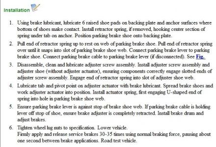

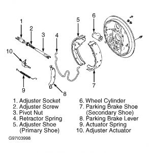

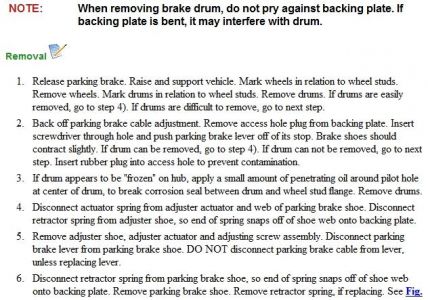

can you tell me step by step how to remove the old shoes brake with whole kit and how to reinstall the new one back step by step ?
