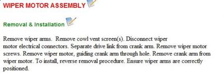

how do I change the windshield wiper motor in my car?
Apr 6, 2010 at 1:49 PM
BLUELIGHTNIN6
  • 16,542 POSTS
https://images.2carpros.com/forum/automotive_pictures/261618_Noname_1978.jpg
Apr 6, 2010 at 3:58 PM
