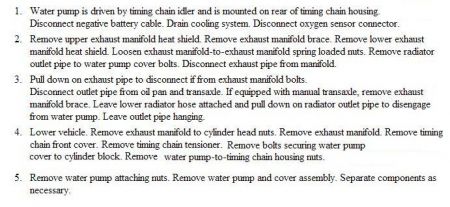

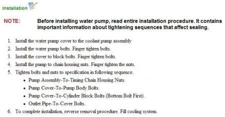

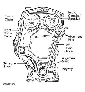

1997 Chevy Malibu 4 cyl Front Wheel Drive Automatic
how do I get the water pump gear off and and the markings for the timing on the timing chain
