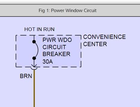

I have a 94 chevy lumina van, all of the power windows have stopped working. My Haynes manual showed the location under the dash on the passenger side. But the fuse they said was for the windows was for the automatic power locks. Could you please tell me the correct location for the power windows.

Our info shows power window circuit breaker in convenience center under right side of dash.
Also, check the wire harness on hinge side of driver door. May have protective rubber boot covering. Pull the covering back so you can check proper color wire. Make sure those wires haven't worked themselves into. Brown wire is voltage for power windows, black wire is ground. Go from there.
