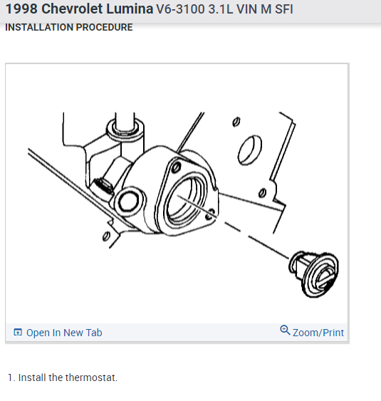

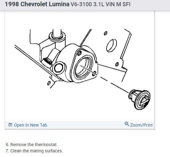

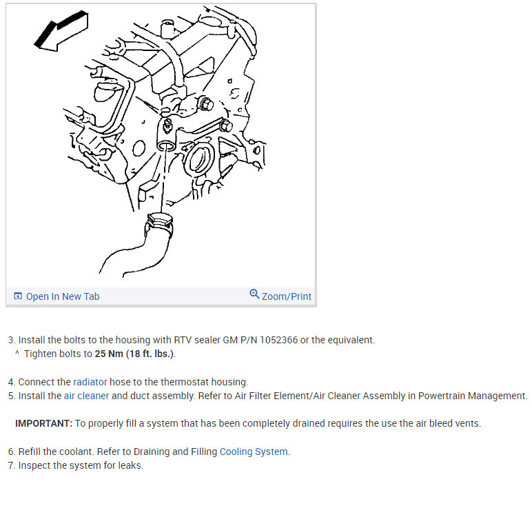

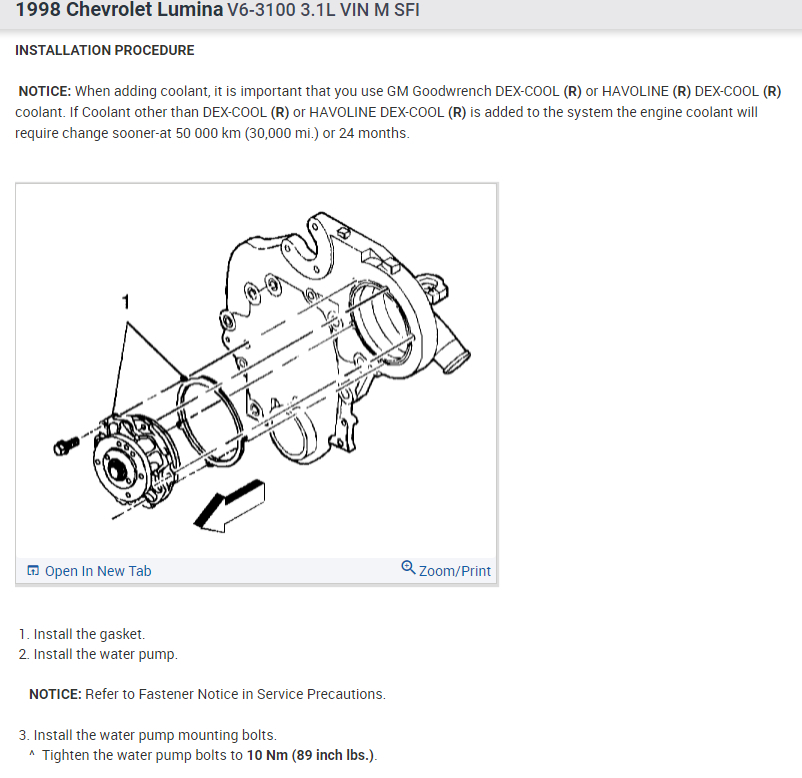

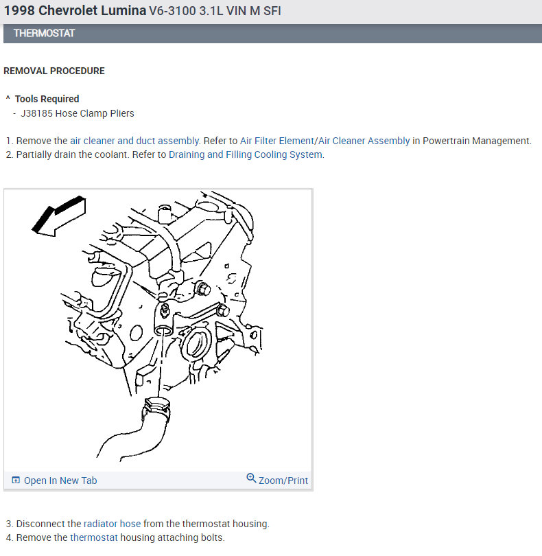

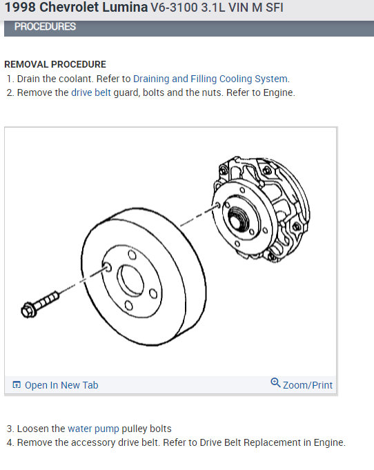

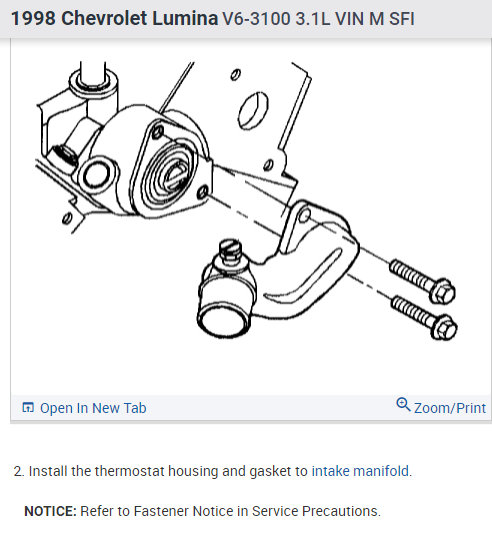

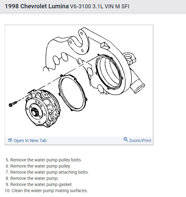

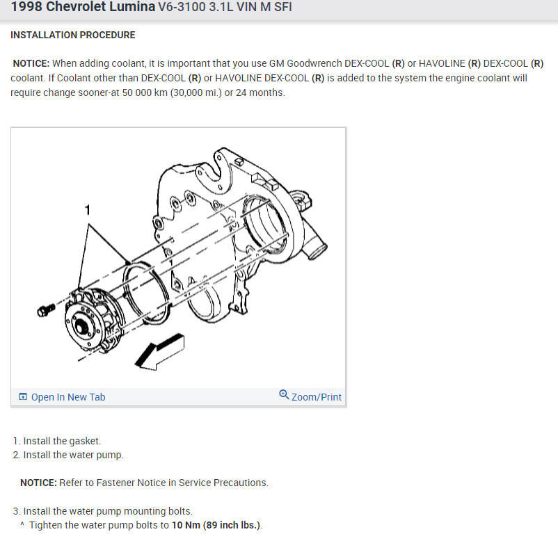

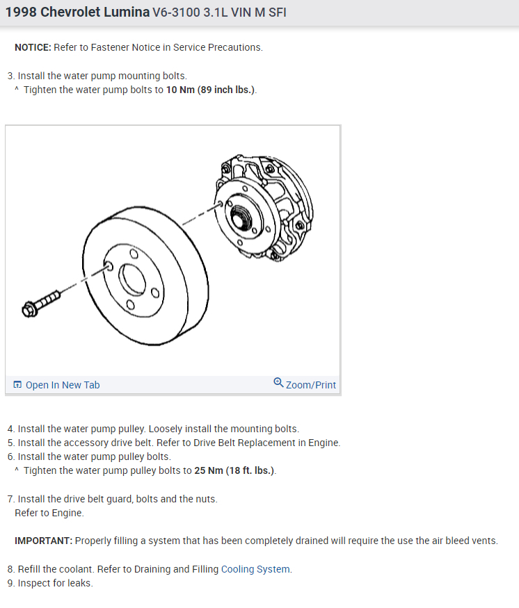

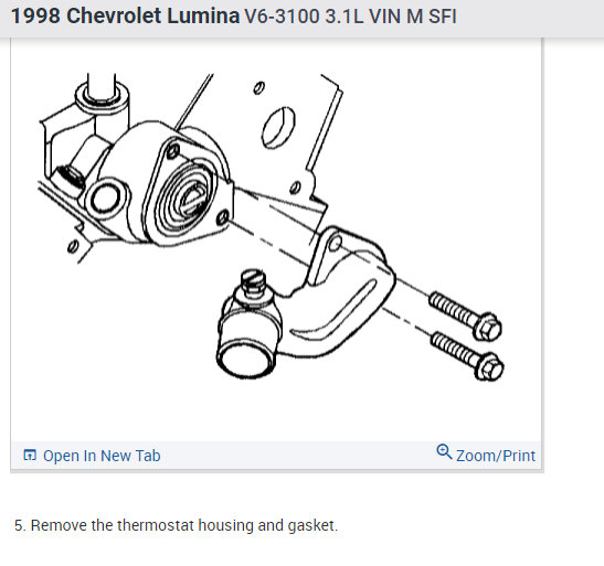

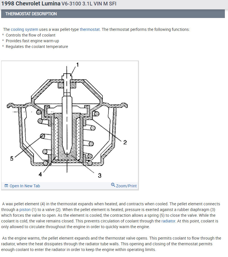

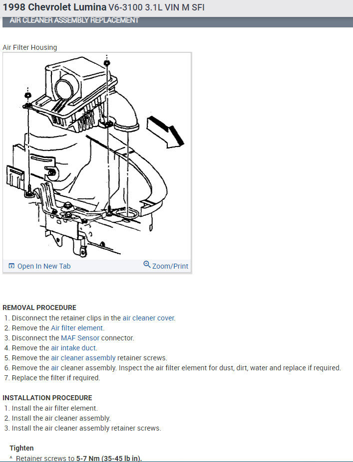

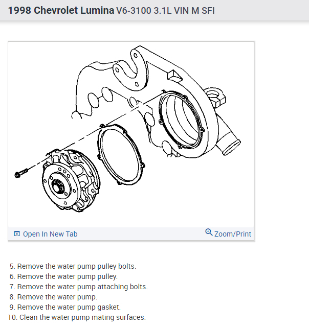

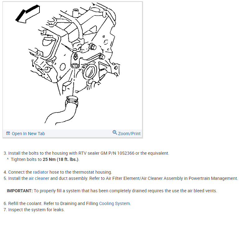

I have attached diagrams for a 1998 Lumina the last year it was produced, as the in 2006 Lumina was not in production.
