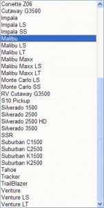

Chevey doesnt show a 2004 Lumiina, and U 1040 is DTC U1001-U1254 Circuit Description Modules connected to the class 2 serial data circuit monitor for serial data communications during normal vehicle operation. Operating information and commands are exchanged among the modules. When a module receives a message for a critical operating parameter, the module records the identification number of the module which sent the message for State of Health monitoring (Node Alive messages). A critical operating parameter is one which, when not received, requires that the module use a default value for that parameter. Once an identification number is learned by a module, it will monitor for that module's "Node Alive" message. Each module on the class 2 serial data circuit which is powered and performing functions that require detection of a communications malfunction is required to send a "Node Alive" message every 2 seconds. When no message is detected from a learned identification number for 5 seconds, a DTC U1xxx , where xxx is equal to the 3 digit identification number, is set. The Control Module ID Number list provides a method for determining which module is not communicating. A module with an internal class 2 serial data circuit malfunction or which loses power during the current ignition cycle would have a Lost Communication DTC set by other modules. The modules that can communicate will set a DTC indicating the module that cannot communicate. When no message is detected from a learned identification number for five seconds, a DTC U1xxx, where xxx is equal to the 3 digit identification number, is set.
https://images.2carpros.com/forum/automotive_pictures/62217_choices_2.jpg
Battery voltage problem, maybe a loose connector. Or bad module, a TechII GM scantool may be needed to figure it out.
