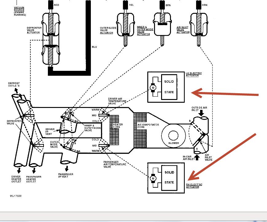

It sounds like the electric actuator for the heat blend it not working. There are two actuators and the right one is the one I suspect to be non operational. Or your heater control valve is stuck closed.

I have a 1998 Chevrolet Lumina with a 3.1. At the end of last winter the heat was on whether the heat control was set to cold or hot. Then suddently it only blew cold air no matter where heat control was set. Now it is winter again and still blows cold air. There is no overheating problem, the heater hoses are both hot, the fan works fine, the climate controls work fine, vent, bi level, defrost, etc. It just blows cold air, I read about temperature control solonoids and actuators that control the flow of heat into the car, where would these be located? Or is it something else like the thermostat?
Aug 18, 2019 at 2:37 AM (Merged)
HMAC300
  • 48,601 POSTS
try pulling hvac fuse first for 60 seconds with key on then reinstall it may reset actuators. not knowing if you have dual zone you may have two of these. also check for a vacuum leak start at engine and work through heater/
MFULLMAN
As it turned out it was the electric actuator or the lack there of one. I am wondering if a certain repair shop didn't remove it in an attempt to get some money out of me. I discovered this by going to a junk yard and finding a car just like mine and examining the heater box on that one, mine was certainly non-existent only a dangling wire. Can you believe that? It just goes to show find a good pull and pay junk yard and do the troubleshooting yourself.

Check the blend door actutor, it could be non functional. It's on the heater plenum, disconnect the actuator, see if you can move it by hand....lubricte the shaft...

I've been here before-blower coming On no heat-it turns out that the blower fan is freewheeling-instead of moving at the same rpm with the motor.
Could also be the aix mix/blend/mode doors not opening due to actuator/vacuum problems
