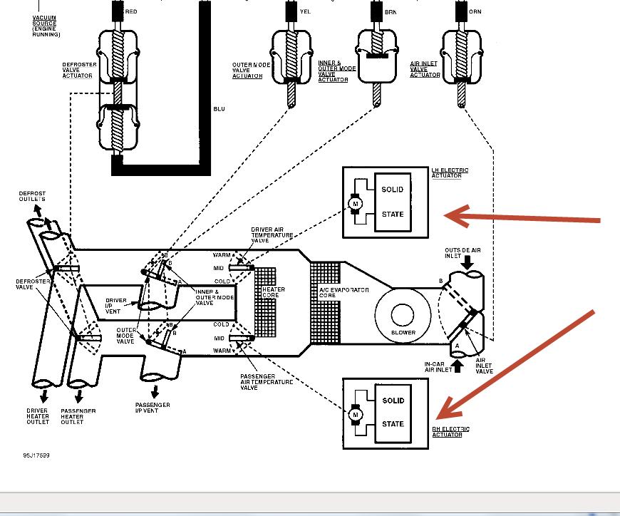

It sounds like the electric actuator for the heat blend it not working. There are two actuators and the right one is the one I suspect to be non operational. Or your heater control valve is stuck closed.
Aug 18, 2019 at 9:37 AM (Merged)

Check the blend door actutor, it could be non functional. It's on the heater plenum, disconnect the actuator, see if you can move it by hand....lubricte the shaft...

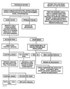

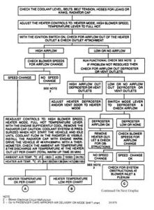

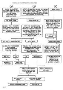

This one sounds like an air bound system. Try removing the radiator cap and squeezing the upper radiator hose while it warms up, once you see the antifrwwze circulating in the recovery tank, make sure it's full then cap it. Here are the TS charts from chevy, this could also be a clogged core!
https://images.2carpros.com/forum/automotive_pictures/62217_Controlsr_1.jpg
https://images.2carpros.com/forum/automotive_pictures/62217_Heat1r_1.jpg
https://images.2carpros.com/forum/automotive_pictures/62217_heat2r_1.jpg
