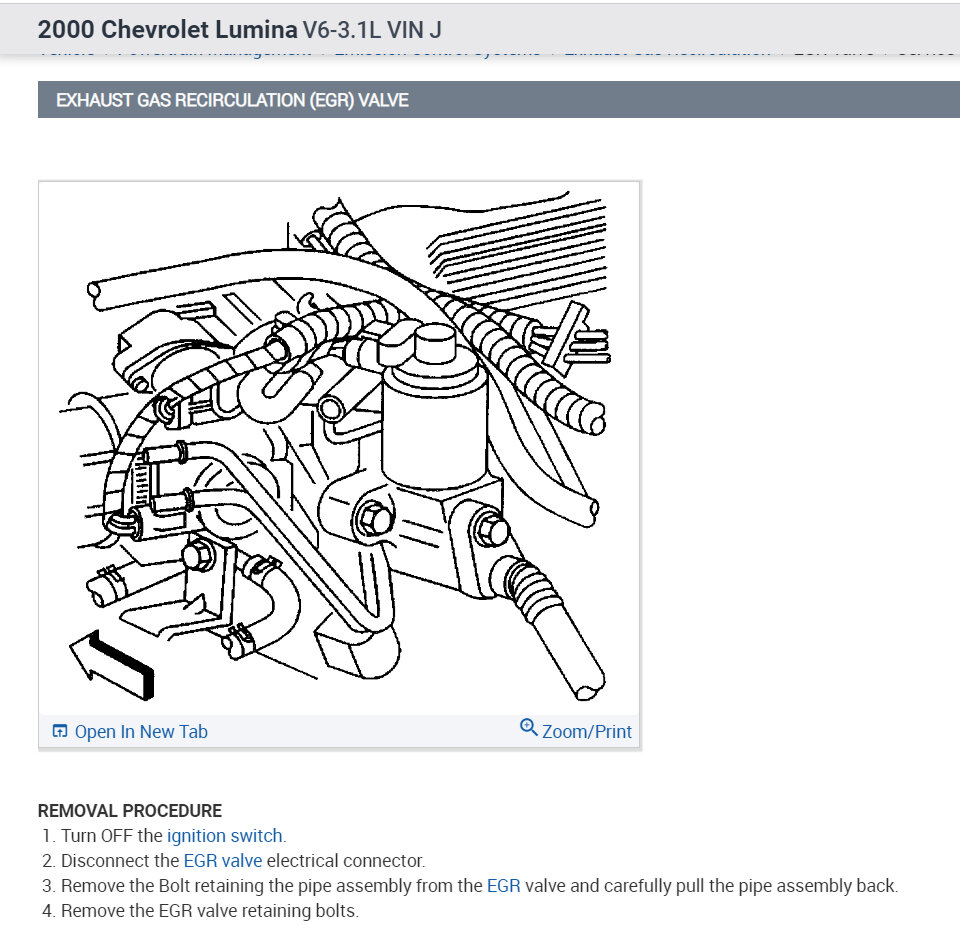

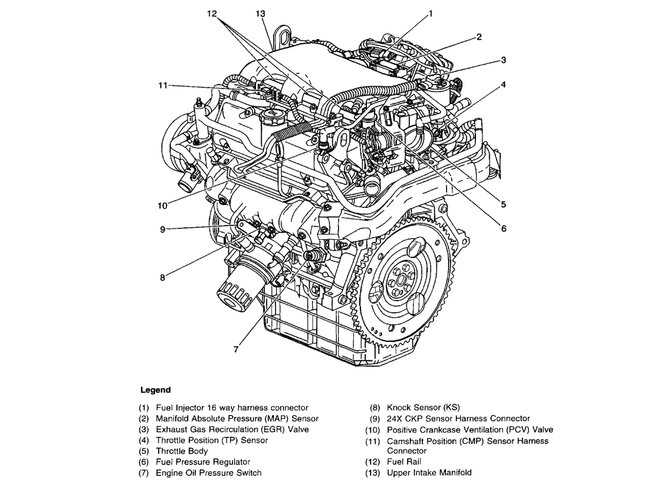

WHERE IS THE EGR VALVE LOCATED

It's located on the top rear of the engine. Check out the images (Below). Please let us know if you need anything else to get the problem fixed.

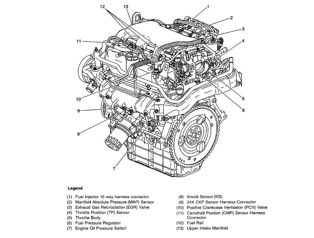

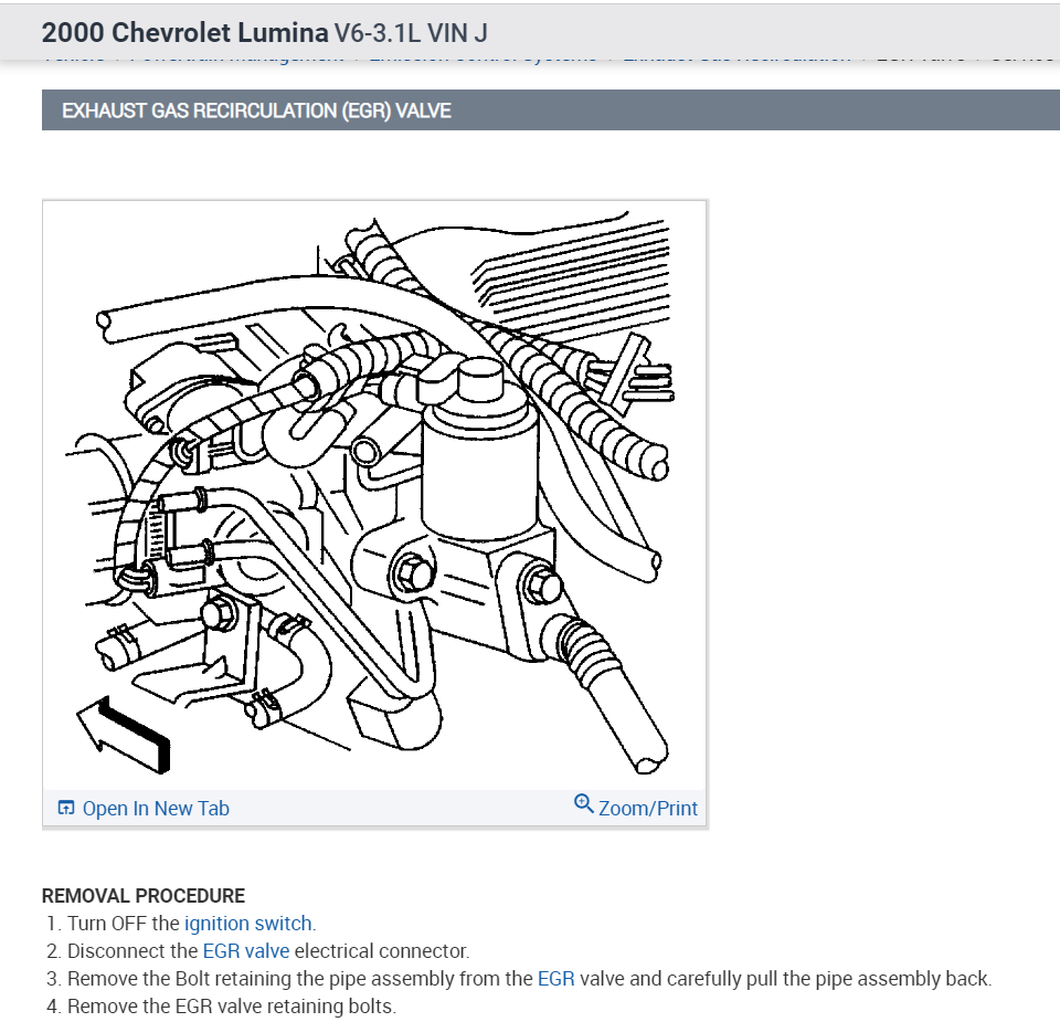

Here is what it looks like......
