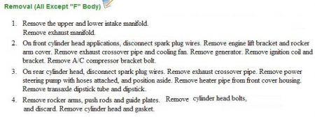

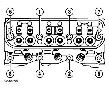

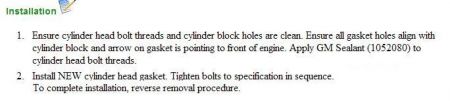

i need information on how to fix my luminas head gasket it is a 1999 chevy lumina and the engine tends to drain coolant and oil within seconds
Aug 14, 2009 at 10:07 AM
BLUELIGHTNIN6
Experienced Mechanic
16,542 POSTS
3.1L or 3.8L engine?
Aug 14, 2009 at 10:09 AM
DRACKILL1
MEMBER
3 POSTS
3.8
Aug 14, 2009 at 10:12 AM
BLUELIGHTNIN6
16,542 POSTS
Aug 14, 2009 at 10:18 AM
