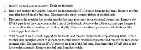

how do you remove the gas tank???

https://images.2carpros.com/forum/automotive_pictures/261618_Noname_1074.jpg
