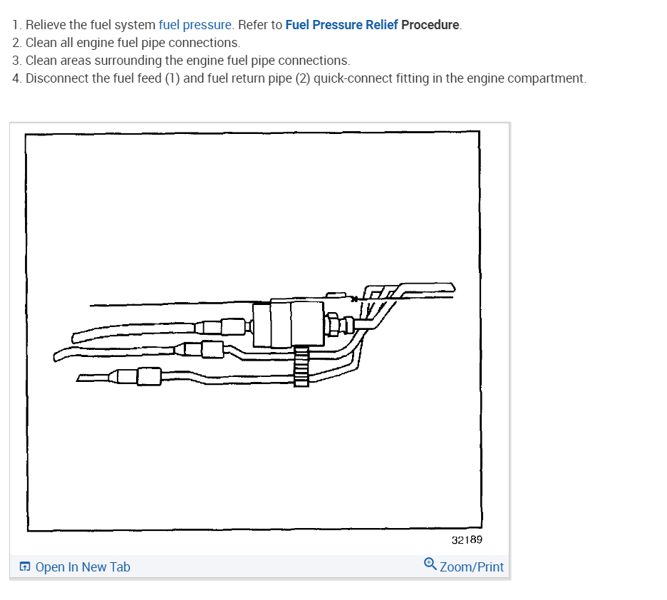

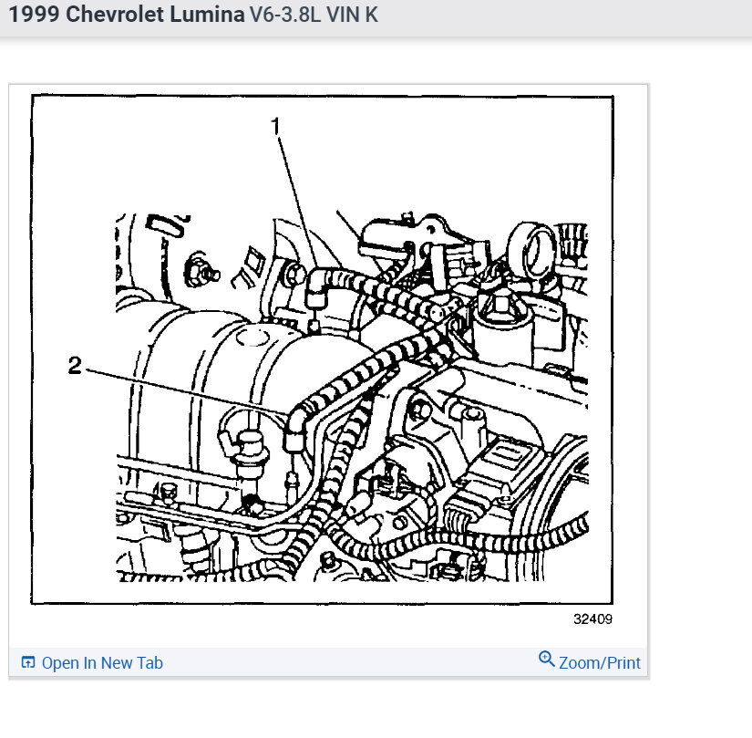

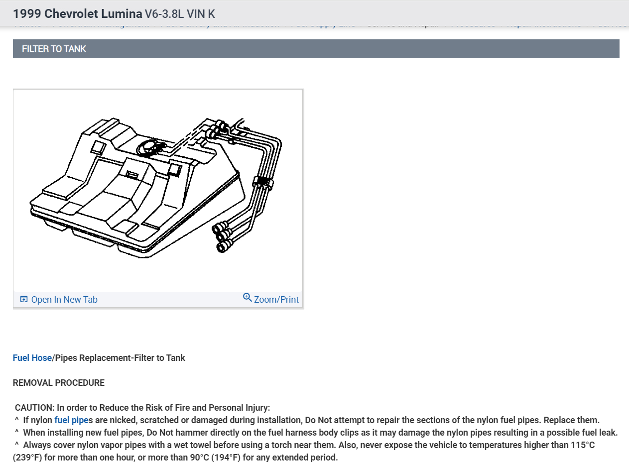

Here are the fuel line diagrams in case you need them. Check out the images (Below). Please let us know how it goes
