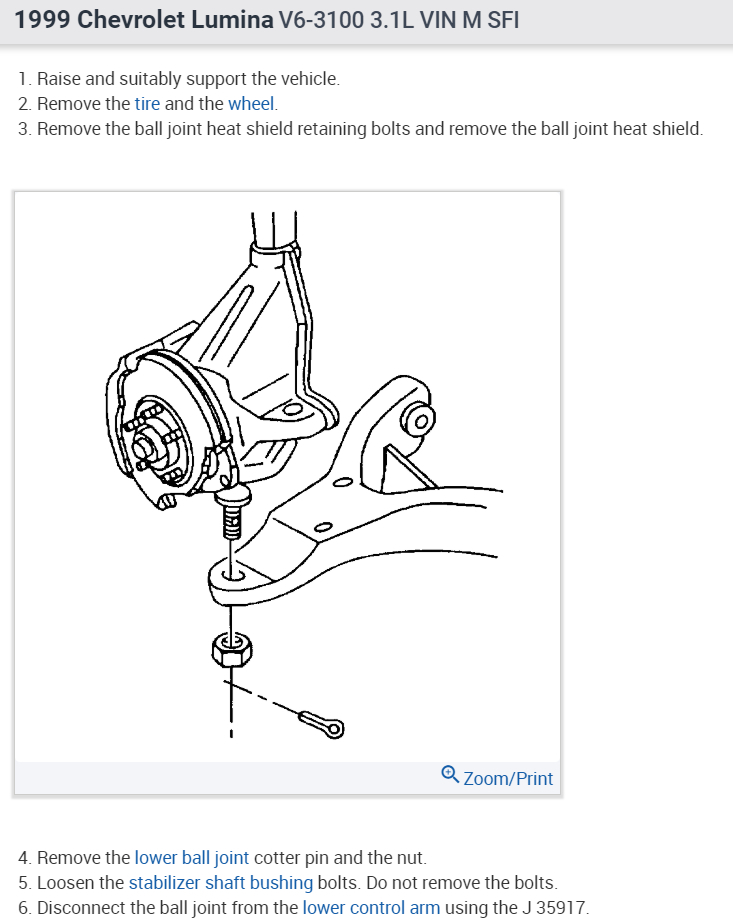

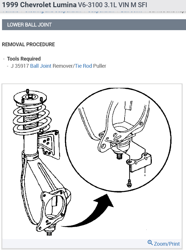

The left front ball joint needs to be replaced and I need to know how to remove the old one.
Apr 17, 2008 at 6:53 AM
DNAPRORACING
  • 120 POSTS
Here are diagrams below with instructions so you can replace the lower ball joints. Check out the diagrams (below). Please let us know if you need anything else to get the problem fixed.
https://www.2carpros.com/articles/how-to-release-a-ball-joint
Cheers
