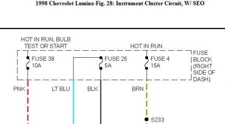

My 1998 lumina' instrument panel lights were gone while other warning light were ok. I removed the cluster and checked the 4 bulbs in the cluster those were ok. I detected votage on the fuse 1, (instrument panel adn console cigar lighters), and foud there was no voltage on the fuse 1.
what could be problem how to fix it?
Thanks for your help!!!
Xiang
Jul 20, 2010 at 5:09 PM
DAVE H
  • 13,384 POSTS
Hello .. thanks for the donation .. much appreciated Check fuses #39, #25 and #4 ..in the fuse block on right side of dashboard .. fuse #39 is the main fuse to the dashboard !

Thanks for your reply. Actually I checked and cleaned all fuse and replaced with new fuses in the fuse box including #39, #25, #4.
I replaced melted fuse #16 for Horn and fixed horn problem last time.

I found that there was no Fuse insert in the #25 fuse panel (this location was empty). in the Car Manual there is #25 location. I do not know how it disapeared. How can add insert plug into this location ? Is it possible cause for instrument panel lights gone? Thanks for further comment and help!
Jul 21, 2010 at 12:11 AM
DAVE H
  • 13,384 POSTS
Thanks for the Feedback !!
You will not have a fuse #25 if you do not have SEO fitted to the vehicle
Some models are equipped with Special Equipment Option (SEO) instrument cluster, which uses a digital speedometer module in addition to the gauges and warning indicators available on the standard cluster. The digital speedometer module receives ignition voltage, ground and Vehicle Speed Sensor (VSS) signal independent of instrument cluster connector. Digital speedometer and radio can be step dimmed to a night mode when headlight switch is activated.

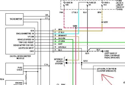

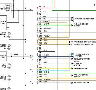

It is intoo profasional manner I even do not konw what is that and where are C5, C6, C8, S203, and circuit No. 150 located that you mentioned in your email.
Can you kinedly sent me a schametic chart, pictures that showing the location and the order in the switch pleas? Actually I disconected all Dash instrument panel plate. But there were so many lines connect to the inserts, so, I do not know whre is switch and what is these terminal.

the connectors are located on rear of instrument cluster !
