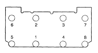

I have a '98 Chevy Lumina 6cyl. 3.1 engine. I am trying to find out when replacing the head bolts how much torque do I use? I want to know the exact specifications. Also I want to know just an idea on how long it should take me to put it all back together. How much labor is involved?

Both heads
https://images.2carpros.com/forum/automotive_pictures/12900_t1_9.gif
Tighten the cylinder head bolts in sequence to 60 Nm (44 ft. lbs.) . Labor: 10hrs
