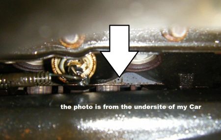

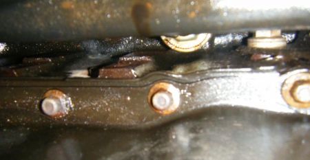

Hi, my name is Andreas and i am from Germany. i have to change the cylinder head gasket from my lumina its an 3.8 liter engine. Is ther also any other gasket to change? if yes which one. Part's

[img:10f4afa876]http://www.2carpros.com/forum/automotive_pictures/580657_cylinderhead_1.jpg[/img:10f4afa876]
[img:10f4afa876]http://www.2carpros.com/forum/automotive_pictures/580657_oilpan_1.jpg[/img:10f4afa876]

You'll be needing the intake manifold gasket, exhaust manifold gasket exhaust pipe donut and valve cover gasket-I can't make out the picture-it looks like a heat shield

[quote:e8d8e3aced="rasmataz"]I can't make out the picture-it looks like a heat shield[/quote:e8d8e3aced]
hi, on the first photo you can see "arrowhead" there is th cylinderhead, bacaus i fix the photo from the undersite of my car, if you look on that photo, there is oil, i think the gasket has aleak. curios, i have no coolant in the oil, only oil coms down
is that possible to got an Gasket Kit for that Motor?

You sure its not coming from the oil pan gasket, oil pressure switch or the valve cover-you need to determine exactly where its leaking, oil leak moves around and can miss lead you

[quote:3c374481eb="rasmataz"]You sure its not coming from the oil pan gasket, oil pressure switch or the valve cover-you need to determine exactly where its leaking, oil leak moves around and can miss lead you[/quote:3c374481eb]
Hi, oil pan gasket no, because the oil comes from top.
Maybe oil pressure switch or the valve cover,because around that switch and to the right is a lot of oil.
I think i have at first to clean up the motor,and then i watch where the oil comes from.
