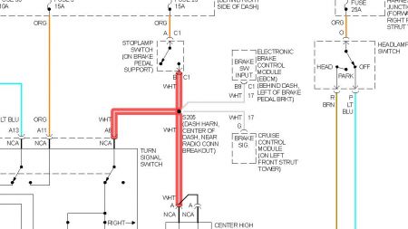

my brake lights on side works when they want to but the one in rear window works good i was told i need a turn single relay but my turn singles work

If wire at splice S205 is okay-its coming from the trun signal switch
https://images.2carpros.com/forum/automotive_pictures/12900_splice_1.jpg
