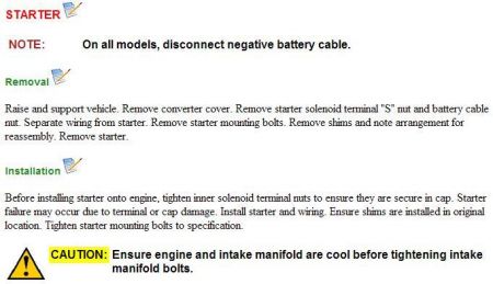

how do i take the starter off of my car and put one back on

https://images.2carpros.com/forum/automotive_pictures/261618_Noname_987.jpg
