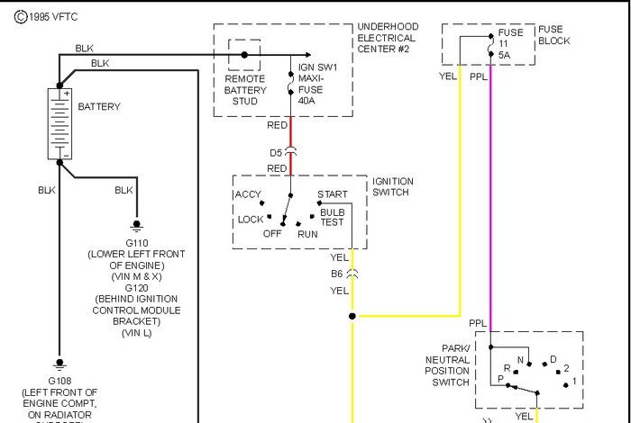

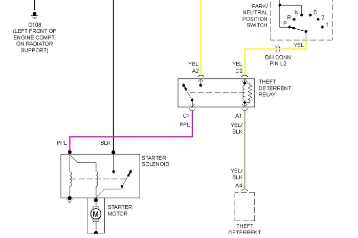

Is there a pellet in the key? There is information all over the web about bypassing that pellet, but, if the problem is elsewhere in the security system, that bypass will not work.
You could use a remote starter button on the starter solenoid, to see if it will crank? The leads on mine are not long enough to get me away from the vehicle, You have to be sure the transmission is in park or neutral and a functional e-brake is set. Even if you can crank it, if security issue, it still will not start, because of fuel enable.
Below is wiring for your starter.
Aug 30, 2018 at 4:20 AM (Merged)
