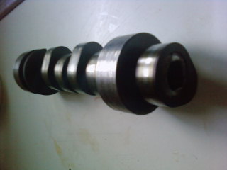

WHAT WOULD CAUSE A CAMSHAFT TO SNAP INTO ON A 3.1 LTR [img:528924a3a6]http://www.2carpros.com/forum/automotive_pictures/372831_062309_060700_1.jpg[/img:528924a3a6]TOOK THE MOTOR APART TO SEE WHAT WAS WRONG WITH IT THE TIMMING CHAIN LOOKED VERRY GOOD AND IN TIME COME TO FIND OUT THAT WHEN I PULLED THE CAM OUT IT WAS IN TWO PICES NEVER SEEN ANYTHING LIKE IT TRYING TO GET INFO PLEASE HELP ITS A FAMILY CAR NOT A HOT ROD CAR JUST QUIT THE INTERNAL MOTOR IS VERY CLEAN OIL ALWAYS CHANGED

Hi there,
If there is no evidence of cam bearings nipping up due to oil starvation, this may be case of a defective billet cam and fatigue has taken its toll.
Mark (mhpautos)
