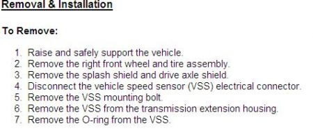

where does the input speed sensor go in a 97 lumina?

hi, are you talking about the vehicle speed sensor?
