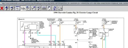

My daughter is home for Xmas break and her Tail lights, license plate light front parking lights and Instrument Panel light are all out. I found out that the 25A fuse in the underhood electrical center powers all of these lights. Fuse looked good but changed it anyway with NO results. Checked the wiring under the UEC to make sure it was connected and for corrosion and wiggle the wires around. Still NO success. Where else can i look to find the source of the problem? Thank you in advance!!!
Mike
Jan 6, 2009 at 12:41 AM
DAVE H
  • 13,384 POSTS

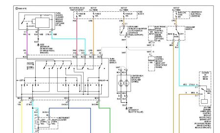

Hello ... Try checking/ replacing the Daytime Running Lamps (DRL) Control Module...Behind left side of dash, on brake pedal support. this controls these systems during daytime running and if it is faulty will not let the lights come on during normal operation ..
https://images.2carpros.com/forum/automotive_pictures/266999_light_2.jpg
Check out the images (Below). Please let us know how it goes

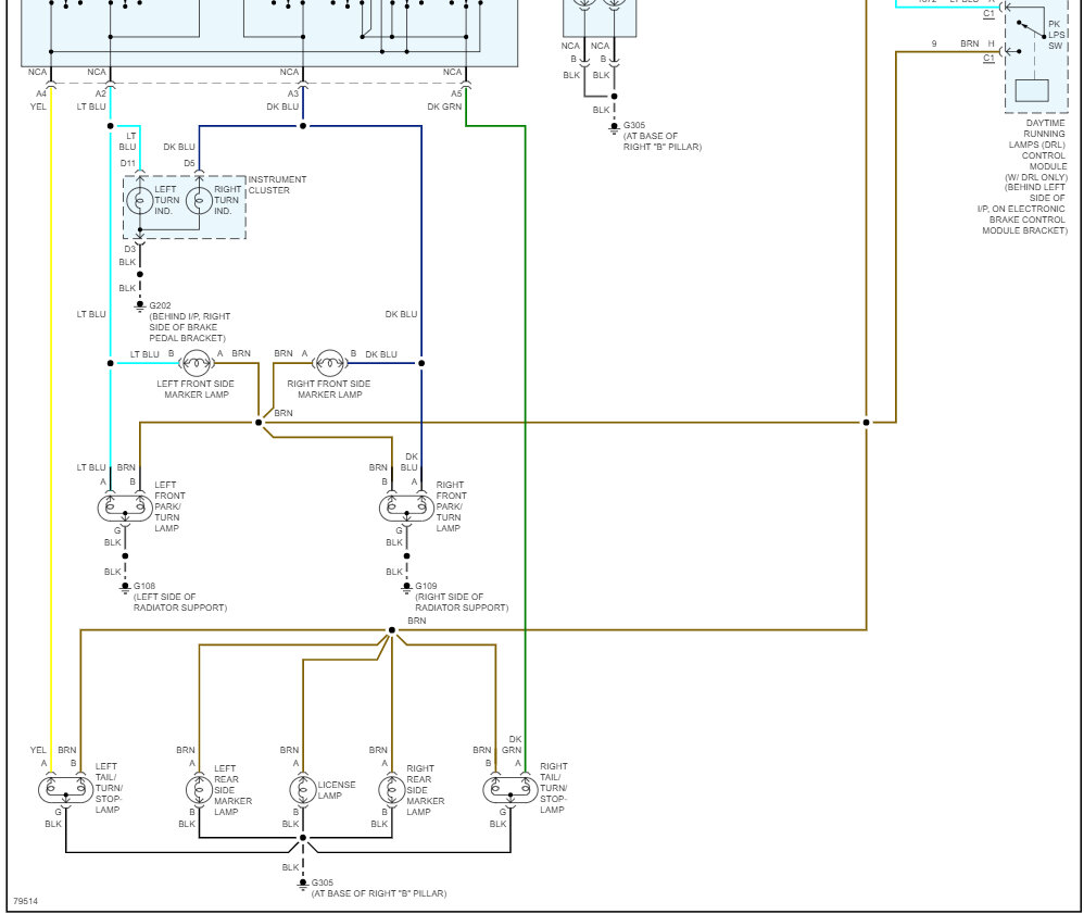

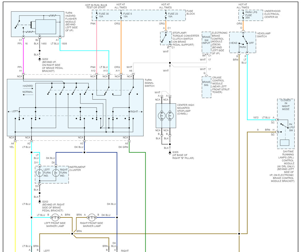

I have 3 models listed of the lumina lumina lumina APV lumina LS I have a DRL listed for each model It looks from the wiring diagram that it maybe optional ? could you supply vin # ... or you could call a dealer with the VIN #
https://images.2carpros.com/forum/automotive_pictures/266999_light2_1.jpg
let me know !

It turns out that part of the UEC was dead. Had to have it replaced.

If you mean the ECU (vehicles computer) then none of the lighting circuits are controlled by the ECU the ECU deals with powertrain (engine circuits spark/fuel etc.)... all lighting circuits are controlled by switches/fuses the DRL module and EBCM (electronic brake control module) which does control brake light operation but not the other circuits you mentioned ... the DRL and actual lights switch are the only circuit controls for all the lights you mentioned were out ?? if you had the ECU replaced then I feel this was unnecessary !!

The Underhood Electronic Control box (UEC) or fuse panel. There was no power to two of the fuses. One of them was the 25A fuse for those lamps. Apparantly there was some corrosion or something. All i know is it wasn't the control module which i replaced thankfully with one from the salvage yard and only cost me $20.00 instead of the $200 that the dealer wanted.
