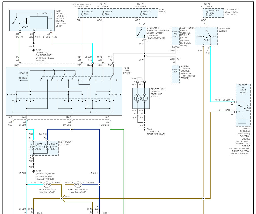

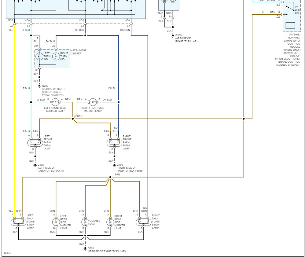

My daughter is home for Xmas break and her Tail lights, license plate light front parking lights and Instrument Panel light are all out. I found out that the 25A fuse in the underhood electrical center powers all of these lights. Fuse looked good but changed it anyway with NO results. Checked the wiring under the UEC to make sure it was connected and for corrosion and wiggle the wires around. Still NO success. Where else can i look to find the source of the problem? Thank you in advance!!!

Hello ... Try checking/ replacing the Daytime Running Lamps (DRL) Control Module...Behind left side of dash, on brake pedal support. this controls these systems during daytime running and if it is faulty will not let the lights come on during normal operation ..
https://images.2carpros.com/forum/automotive_pictures/266999_light_2.jpg
Check out the images (Below). Please let us know how it goes

Thanks for the response. I have tried to find a module at the online auto parts stores and haven't had any luck. None of them have one listed. To be honest, i didn't know this vehicle had DRL's. I don't have the vehicle here at the moment. I'd like to make sure that you have the right vehicle information. It is a 1996 Chevy Lumina.

I have 3 models listed of the lumina lumina lumina APV lumina LS I have a DRL listed for each model It looks from the wiring diagram that it maybe optional ? could you supply vin # ... or you could call a dealer with the VIN #
https://images.2carpros.com/forum/automotive_pictures/266999_light2_1.jpg
let me know !

I called the dealer and it's not a cheap part that would be feasable to just swap out ($207.00) but i located one at a salvage yard for $20.00. It's a rectangular aluminum box about 6"x12"x1 1/4". My daughter is bringing the car by this afternoon and i will swap it out and let you know the results. Thanks again.

It turns out that part of the UEC was dead. Had to have it replaced.

The Underhood Electronic Control box (UEC) or fuse panel. There was no power to two of the fuses. One of them was the 25A fuse for those lamps. Apparantly there was some corrosion or something. All i know is it wasn't the control module which i replaced thankfully with one from the salvage yard and only cost me $20.00 instead of the $200 that the dealer wanted.
