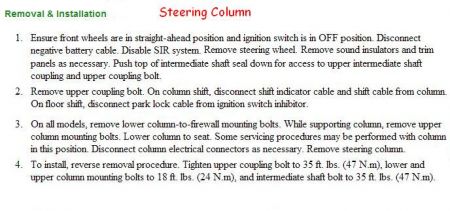

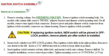

Any diagrams available to show procedure to change ign switch on this car?

are you replacing the actual switch or just the lock cylinder (where key inserts)
Nov 5, 2009 at 7:57 PM
EDDIEN
ignition switch. Lock cylinder ok.
Nov 6, 2009 at 4:49 AM
BLUELIGHTNIN6
  • 16,542 POSTS
https://images.2carpros.com/forum/automotive_pictures/261618_Noname_1153.jpg
https://images.2carpros.com/forum/automotive_pictures/261618_Noname2_334.jpg
