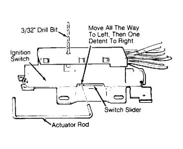

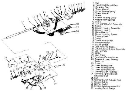

i have 2 cars and im trying to remove the switch in one and put it into the other the problem is i cant seem to get the switches out, please help. got any pictures?

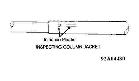

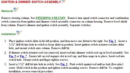

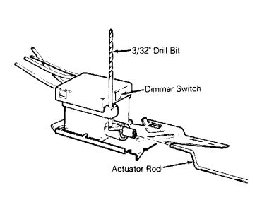

Below is info you requested. Hope this helps. Thanks for using 2carpros.com!
https://images.2carpros.com/forum/automotive_pictures/261618_Noname_21.jpg
FIG. 1
https://images.2carpros.com/forum/automotive_pictures/261618_Graphic_16.jpg
FIG. 2
https://images.2carpros.com/forum/automotive_pictures/261618_Graphic2_2.jpg
FIG. 5
https://images.2carpros.com/forum/automotive_pictures/261618_Noname5_1.jpg
FIG. 7
