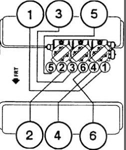

1996 Chevy Lumina 6 cyl Front Wheel Drive Automatic
i need to know what the cylinder for the the right side of the engine if you are standing on the passenger said

https://images.2carpros.com/forum/automotive_pictures/170934_lumina_cylinder_banks_1.jpg
The above picture is for a 3.1 fwd.
