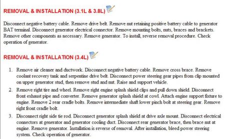

Wife's car kept dying. Charged battery, ran fine for a day, then died. Replaced with new battery. Died while driving next day. Battery must not be getting recharged with Alternator. The engine compartment is SOOOOO tight and compact. Looks like a major task to get to Alternator. Is it doable for the average Joe mechanic?? Doesn't look like it!!

https://images.2carpros.com/forum/automotive_pictures/261618_Noname_1792.jpg
