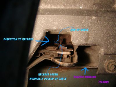

hello.
I have had this van a few years now and recently the cable to release the got broken. Can i open the hood manually somehow? thanks
