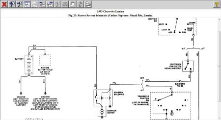

I have put the starter in but haven't hooked it up electrically. Do you have or do you know where I can get a diagram of the electrical hook up. Thanks.
Mar 6, 2010 at 2:11 PM
  • 75,992 POSTS
See below:
https://images.2carpros.com/forum/automotive_pictures/12900_lumina_1.jpg
