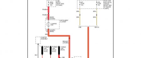

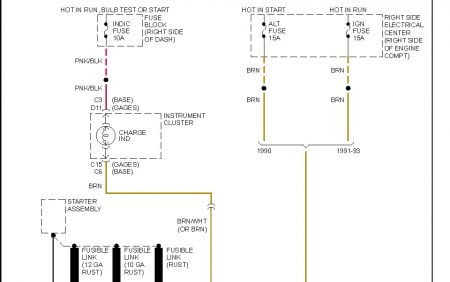

1993 Chevy Lumina 6 cyl Front Wheel Drive
replaced alternator charged batt car started but only ran for about 2-3 min until batt went dead then stalled their is no voltage between the neg. post on batt and the red wire on alt their is no lights on dash in reguards to batt voltage or chk engine
Jul 11, 2010 at 8:08 AM
  • 75,988 POSTS
Inspect and test all the fusible links
https://images.2carpros.com/forum/automotive_pictures/12900_a1_17.jpg
https://images.2carpros.com/forum/automotive_pictures/12900_a2_17.jpg

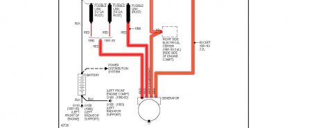

Use a digital multimeter at alternator bat terminal and chassis ground, everything off, it should show battery voltage, if it doesn't, there is an open circuit between alternator and battery. Make sure the battery has a full charge and the connections are good.
https://images.2carpros.com/forum/automotive_pictures/512072_lumina_charging_system_1_1.jpg
https://images.2carpros.com/forum/automotive_pictures/512072_lumina_charging_system_2_1.jpg
