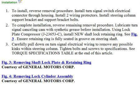

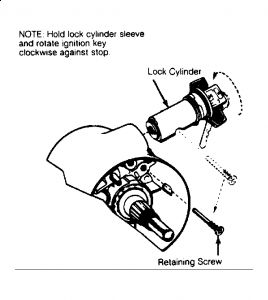

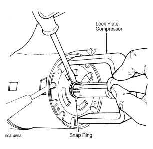

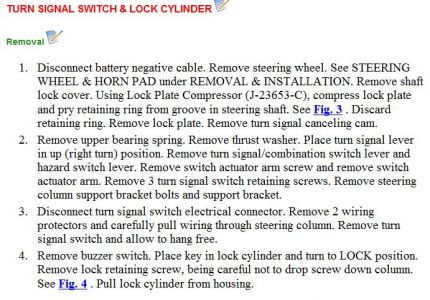

How do you replace Turn Signal lever on a Chevrolet Lumina van APV 1993?

https://images.2carpros.com/forum/automotive_pictures/55316_93apvturn_2.jpg
https://images.2carpros.com/forum/automotive_pictures/55316_93apvturn2_1.jpg
https://images.2carpros.com/forum/automotive_pictures/55316_93apvturn3_1.jpg
https://images.2carpros.com/forum/automotive_pictures/55316_93apvturn4_1.jpg
