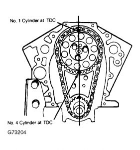

I have a 3.1 litre v6 that I am replacing the broken timing chain on and need to know how to syncronize the crank and Cam.

Hi there, Timing chain set up see pic, mark (mhpautos)

Hey thanks Mark for the diagram. Do you happen to know the torque specs for the cam sprocket bolts?

I was able to find the specs. Thanks for your help.
