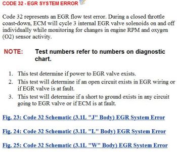

My car is runing ruff. I checked my codes and code 32 came up. I need to know what the code 32 is and how to fix it.

For proper diagnostic, I need to know more about your vehicle.
Is it Lumina car or APV?
Trim level: LT, Euro or Z34
Engine size: 3.1 or 3.4
I need the first 8 digit of the VIN

It's a 3.1 t motor 6 cly

For proper schematic, I still need to know the VIN code. Please post the first 8 digits of the VIN number.
